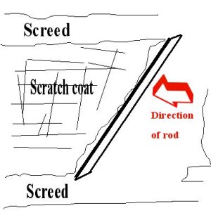

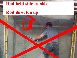

Rule one: Don't rod a block wall up. Only side to side.
You can't see the block joints on any of
my jobs.
Period.

After scratch coat sets hard(overnight for stucco),
brown coat may be applied.
Screeds are set with a rod or a string line. Wall is filled in between
the screeds. Wall is then rodded side-to-side. If not, you will see
the block
joints.
