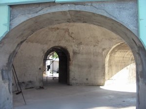

Hello Reggie,
I am building a castle made
from
concrete.
Here is a picture of the inside of the kitchen. If
I want to finish the
walls with a lime
plaster, do I need to do
anything
special
to get the best bond between the cement base and
the lime finish?
I
Cool kitchen.
