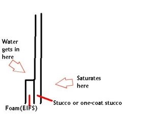

Are the foam place on's a problem. We are planning to use them
around
the windows. Do they collect moisture? Are they not long
lived?
Thanks. Of course they collect
moisture

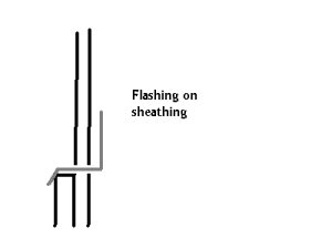

and even rot your house. In
Flashing all the way back to the substrate should prevent
water
