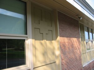

These foam and EIFS crosses were supposed
to be Cement stucco with a color cement finish.
I have a lot of first hand knowledge of these buildings
at this church in Arlington, VA. I bid on the stucco with
Whitener and Jackson, a old customer of mine, who
didn't get the contract. One of the reasons may even have
been the cost difference between cement crosses and
fake EIFS garbage.

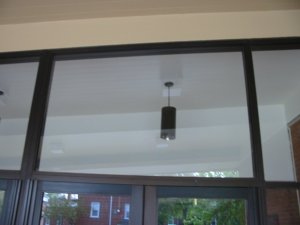

We put this lath and plaster ceiling in the same building
as the fake crosses about 5 years ago.

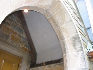

We put in this lath and stucco ceiling in the main entrance
of the church about 3 years ago.
