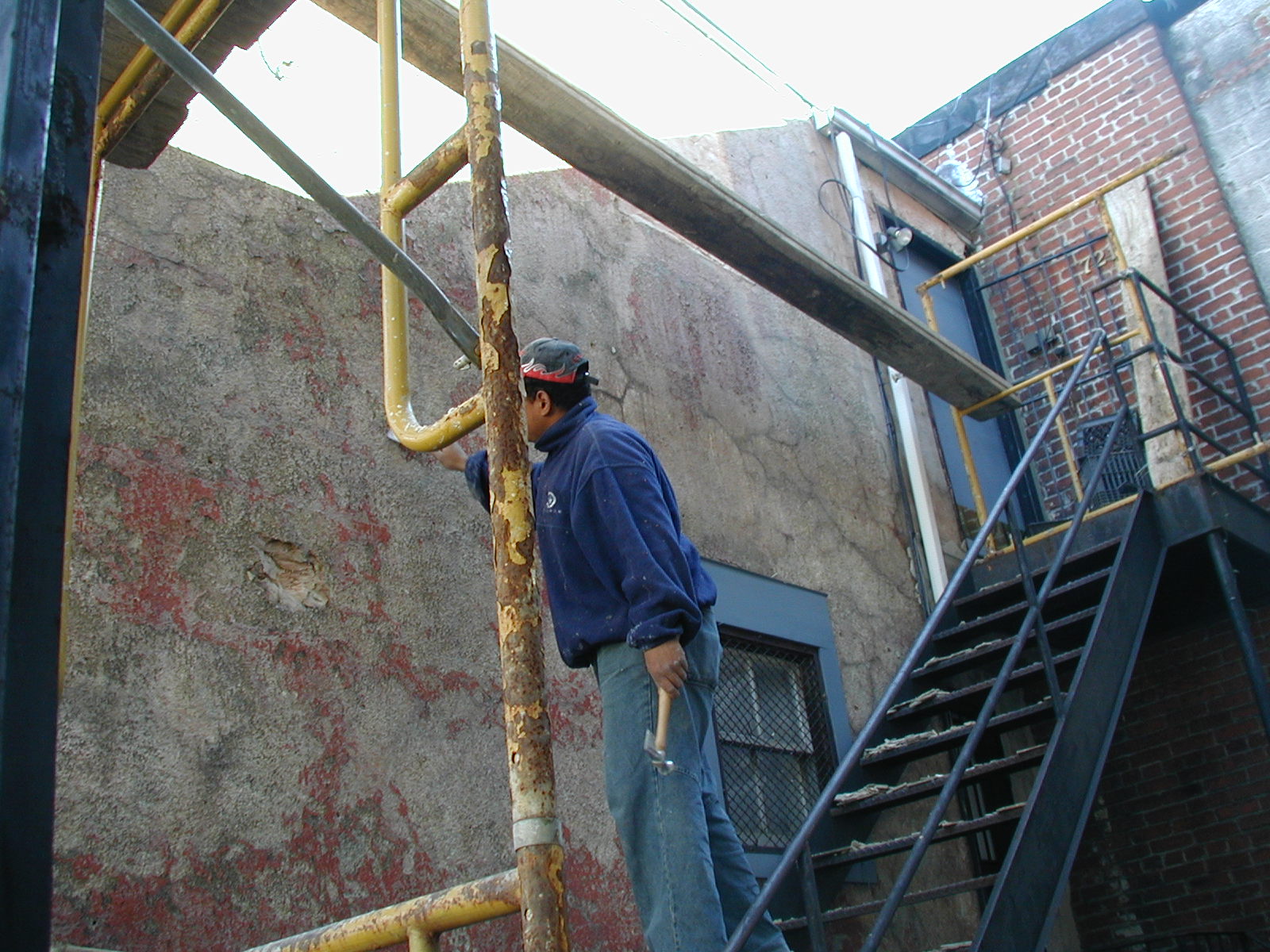

We scraped this stucco off in about 10 minutes. It was loose and popping off the wall. The pink plaster weld was made for interior use. Whenever you see stucco popping off and it is pink underneath, it is plaster weld or a bonding agent used for interior use. If it is blueish it is Sta-dri link, which always fails. If it is blue, it is weld-crete. Even though weld-crete is made for exterior use, it fails often. Weld crete doesn't work well on a painted surface. It is embarrassing for me to admit, we used Weld-Crete many years ago for stucco and it is all popping off the wall.
