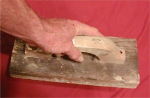

I live in New Orleans. I was wondering what tool was used to finish the stucco on the old buildings. The finish is very flat and almost smooth.

The tool they used was a cork float. I still have my cork float, although I haven't used it in years. It is way too slow

Years ago, here in Virginia, cork floats were used by plasterers to float cement basecoats. This process was slow but provided a very dense, crack resistant basecoat.
If you happen to use a cork float, never let it soak in a bucket of water. The glue will dissolve and they fall apart. If they are kept clean they last a long time.
Somewhere in history, our forefathers decided cork was an ideal material to float stucco with. Cork is great, but way too slow.
