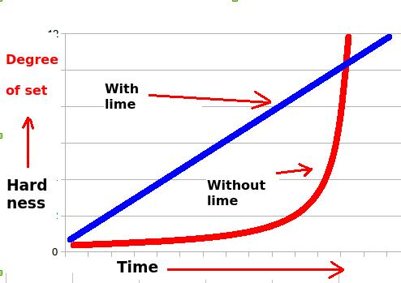

This chart shows how lime starts the initial set of cement mortar, and delays the final set.
Mortar is not firm enough to rod off or work with until it starts to set. For example, a finish coat of stucco is to be rubbed with a rubber float when it starts to set up. Without lime to add an early firmness to the mortar, one would have to wait a long time for the finish to start to set, and not have enough time to float their wall or section.
