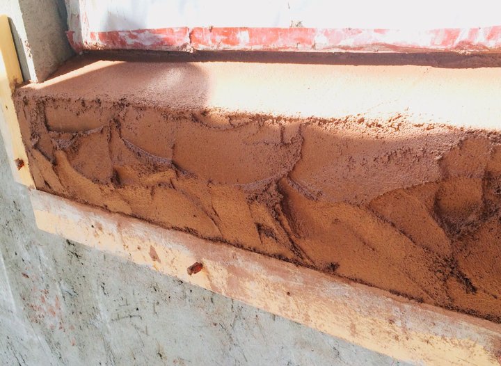

Faux split face brownstone window sills are done with paint tint in Arlington, Virginia
Faux split face brownstone window sills are done with paint tint from the paint store.

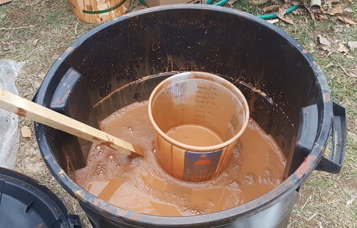

Color for stucco is made in a 32 gallon garbage can in Arlington, Virginia
20 gallons of liquid is made in a 32 gallon garbage can
That is 10 gallons of water, 10 gallons of flex-con, and 4 containers of color.

Color is mixed 20 gallons at a time in a clean 32 gallon garbage can. The cans are washed out into 5 gallon buckets. Remember, 20 gallons is 2 five gallon buckets of water and 2 5 gallon buckets of flex-con.
