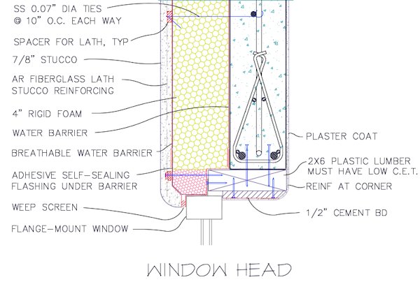

Dear Reggie: We have figured out a way to pump concrete to cast walls in place without any forms. Long story. This makes it easier to build thermally beneficial homes: concrete inside, foam outside. Ideally no vegetable matter anywhere. A few details and images are attached. The reason for writing you is that this uses stucco over the 4" +/- foam. It ties to the concrete with SS wires that are previously cast in place. Before stucco, we trowel on a breathable waterproofing - which is actually leftover silicone from a solar panel manufacturer that went broke. That's right, even a photo above. The first test project has had no stucco problems, but it is very small. Fiberglass lath - we are right next to the Pacific. Lime + white cement. The first real (20'x40') building is now underway, and I am very interested in whatever you may think about this approach to stucco cladding will hold up. How we tie the lath into place is definitely not the easiest - in fact it is the most laborious / least efficient aspect of the construction method. Of course EIFS would be so easy, but given the foam substrate, I prefer cladding that is not extremely flammable. Thank you very much!
A view of the window head detail showing the tie wire cast in place for the metal lath

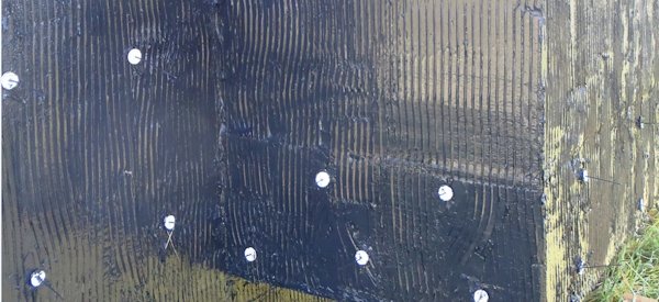

A view of the wire ties through the spacers.

One idea I had is to twist the wire around a nail
or a screw. and tighten up the lath by twisting the nail.
Once the mortar sets up the nail will never untwist.
