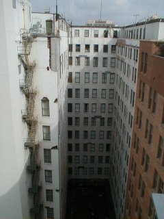

the same way. However, we are doing some exterior renovation to a hotel
in New Orleans where we are replacing brick shelf angles then
reapplying
stucco. The walls have quite a few windows and the architect wants to
deduct
them from the overall square footage.
