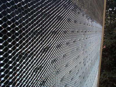

They used diamond mesh on one of our city buildings and
there I suspect though, that the two coat stucco might not cover
the I like the idea of having the foam between the sheathing |
