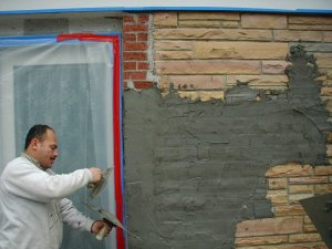

Here, acrylic bonding admixture is used in the scratch coat over these flagstones. Does it work ? I guarantee it.
